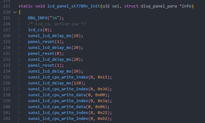

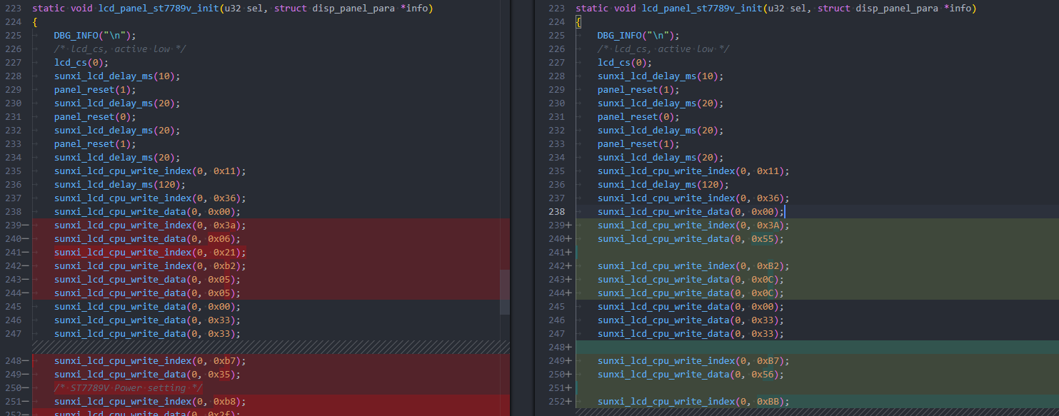

编写屏幕驱动
选择一个现成的 LCD 驱动改写即可,这里选择 st7789v_cpu.c 驱动来修改。
找到初始化序列的部分 static void lcd_panel_st7789v_init(u32 sel, struct disp_panel_para *info)
把原来的初始化序列删除,然后将屏厂提供的初始化序列复制进来。
| 屏厂函数 | LCD框架接口 |
Writecom | sunxi_lcd_cpu_write_index |
Writedat | sunxi_lcd_cpu_write_data |
Delayms | sunxi_lcd_delay_ms |

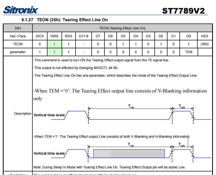

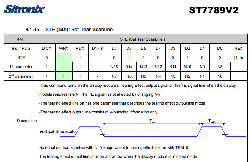

配置屏幕使用 TE 模式
由于屏幕支持 TE,这里可以配置使用 TE 模式,参考屏幕驱动 IC 手册,查看 TE 启用的寄存器,或者询问屏厂。针对 ST7789V2 IC 驱动,其开启 TE 的寄存器是 35H
配置 TE 时钟的寄存器是 44H
这里配置启用 TE,并且设置 TE 时钟为60Hz。在初始化中写入启用 TE 功能的如下代码

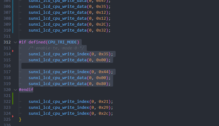

#if defined(CPU_TRI_MODE)
/* enable te, mode 0 */
sunxi_lcd_cpu_write_index(0, 0x35);
sunxi_lcd_cpu_write_data(0, 0x00);
sunxi_lcd_cpu_write_index(0, 0x44);
sunxi_lcd_cpu_write_data(0, 0x80);

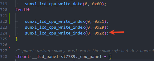

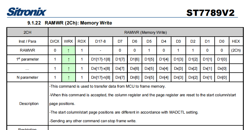

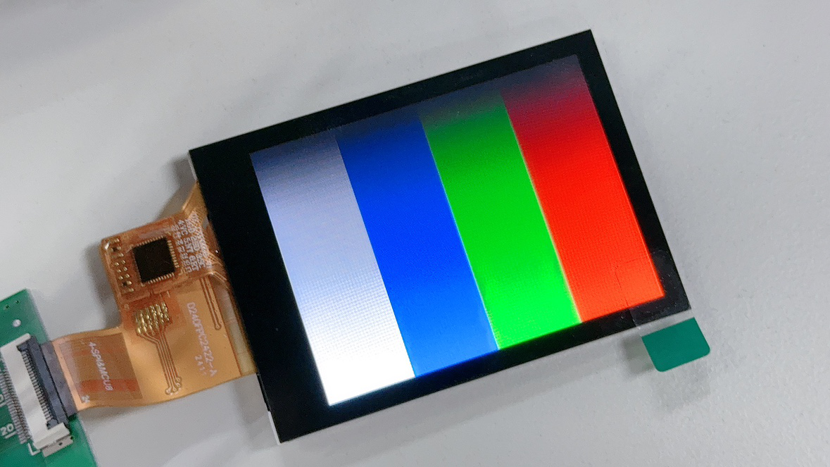

配置屏幕开启
针对 i8080 屏幕,还需要写入 21H,29H开显示之后,还需要开启 GRAM 写入,对应寄存器是 2CH,一般屏厂会在初始化中提供,但是也有屏厂初始化中不提供这个指令。

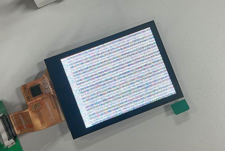

如果出现这样屏幕可以亮但是花屏,且送显示没有反应的情况(如下图)
可以尝试增加开启 GRAM 写入的指令到初始化序列最后一行:
sunxi_lcd_cpu_write_index(0, 0x2c);
DBG_INFO("\n");
/* lcd_cs, active low */
lcd_cs(0);
sunxi_lcd_delay_ms(10);
panel_reset(1);
sunxi_lcd_delay_ms(20);
panel_reset(0);
panel_reset(1);
sunxi_lcd_delay_ms(120);
sunxi_lcd_cpu_write_index(0, 0x11);
sunxi_lcd_cpu_write_index(0, 0x36);
sunxi_lcd_cpu_write_index(0, 0x3A);
sunxi_lcd_cpu_write_data(0, 0x55);
sunxi_lcd_cpu_write_index(0, 0xB2);
sunxi_lcd_cpu_write_data(0, 0x0C);
sunxi_lcd_cpu_write_data(0, 0x33);
sunxi_lcd_cpu_write_index(0, 0xB7);
sunxi_lcd_cpu_write_data(0, 0x56);
sunxi_lcd_cpu_write_index(0, 0xBB);
sunxi_lcd_cpu_write_data(0, 0x20);
sunxi_lcd_cpu_write_index(0, 0xC0);
sunxi_lcd_cpu_write_data(0, 0x2C);
sunxi_lcd_cpu_write_index(0, 0xC2);
sunxi_lcd_cpu_write_data(0, 0x01);
sunxi_lcd_cpu_write_index(0, 0xC3);
sunxi_lcd_cpu_write_data(0, 0x0F);
sunxi_lcd_cpu_write_index(0, 0xC4);
sunxi_lcd_cpu_write_index(0, 0xC6);
sunxi_lcd_cpu_write_index(0, 0xD0);
sunxi_lcd_cpu_write_data(0, 0xA4);
sunxi_lcd_cpu_write_data(0, 0xA1);
sunxi_lcd_cpu_write_index(0, 0xD6);
sunxi_lcd_cpu_write_index(0, 0xE0);
sunxi_lcd_cpu_write_data(0, 0xF0);
sunxi_lcd_cpu_write_data(0, 0x06);
sunxi_lcd_cpu_write_data(0, 0x07);
sunxi_lcd_cpu_write_data(0, 0x05);
sunxi_lcd_cpu_write_data(0, 0x30);
sunxi_lcd_cpu_write_data(0, 0x44);
sunxi_lcd_cpu_write_data(0, 0x48);
sunxi_lcd_cpu_write_data(0, 0x38);
sunxi_lcd_cpu_write_data(0, 0x11);
sunxi_lcd_cpu_write_data(0, 0x10);
sunxi_lcd_cpu_write_data(0, 0x2E);
sunxi_lcd_cpu_write_data(0, 0x34);
sunxi_lcd_cpu_write_index(0, 0xE1);
sunxi_lcd_cpu_write_data(0, 0x0A);
sunxi_lcd_cpu_write_data(0, 0x0E);
sunxi_lcd_cpu_write_data(0, 0x0D);
sunxi_lcd_cpu_write_data(0, 0x0B);
sunxi_lcd_cpu_write_data(0, 0x27);
sunxi_lcd_cpu_write_data(0, 0x2F);
sunxi_lcd_cpu_write_data(0, 0x47);
sunxi_lcd_cpu_write_data(0, 0x35);
sunxi_lcd_cpu_write_data(0, 0x12);
sunxi_lcd_cpu_write_data(0, 0x32);
sunxi_lcd_cpu_write_index(0, 0x21);
sunxi_lcd_cpu_write_index(0, 0x29);

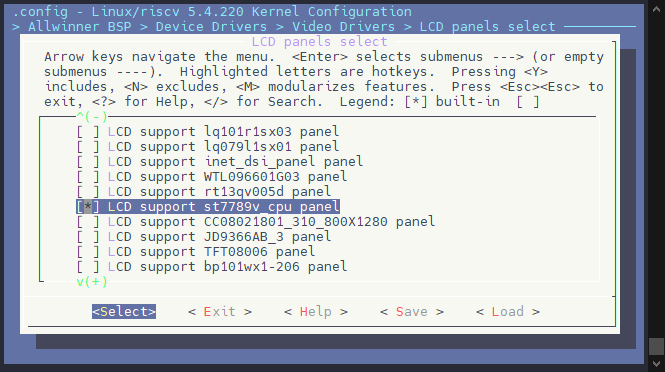

配置屏幕驱动
进入内核,勾选 ST7789V_CPU 驱动。

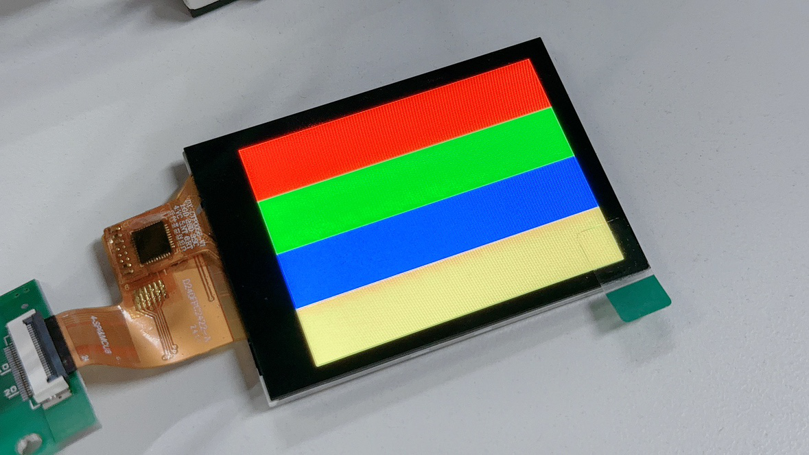

测试屏幕
使用 命令查看 TCON 彩条,这个彩条是由 TCON 发出的,操作更加底层。
使用命令查看 DE 彩条,这个彩条是由 DE 合成发出的,如果 DE 出问题则可以看到 TCON 彩条看不到 DE 彩条。
如果刚才开了 TCON 彩条,记得先关一下,TCON 彩条优先级更高
echo 0 > /sys/class/disp/disp/attr/colorbar
echo 8 > /sys/class/disp/disp/attr/colorbar

I8080接口显示抖动有花纹
- 改大时钟管脚的管脚驱动能力,改大。
