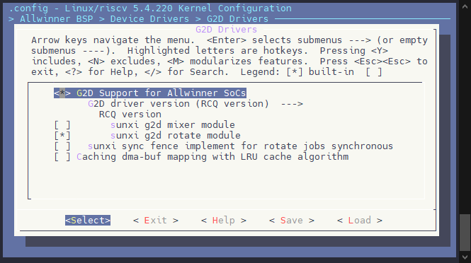

模块功能配置
模块内核配置
Allwinner BSP  --->
Device Drivers --->
G2D Drivers --->
<*> G2D Support for Allwinner SoCs
G2D driver version (RCQ version) --->
RCQ version
[ ] sunxi g2d mixer module <-- V821 不支持,不需要开
[*] sunxi g2d rotate module
[ ] sunxi sync fence implement for rotate jobs synchronous
[ ] Caching dma-buf mapping with LRU cache algorithm
image-20250723102843030
