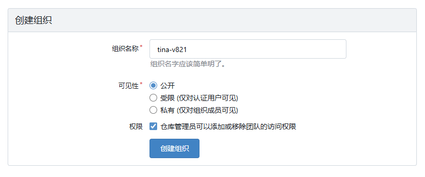

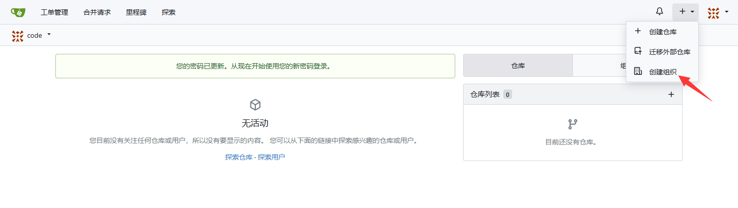

创建组织
点击加号,点击创建组织
image-20250705104246722
然后新建一个组织,叫做 tina-v821
image-20250705104430988

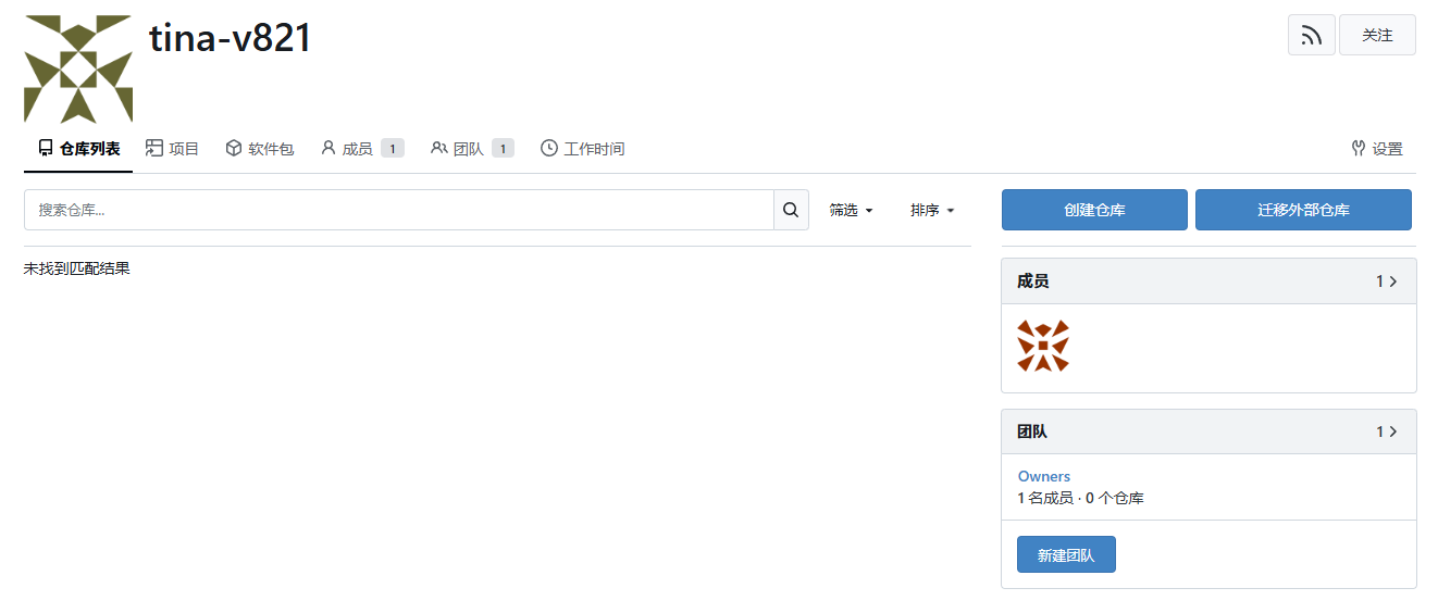

创建组织完成
image-20250705104448741

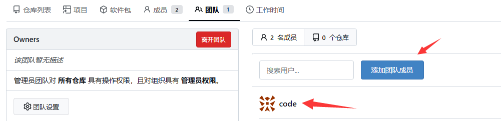

如果显示失败,请将用户添加到团队成员
Error: Given user is not allowed to create repository in organization.
点击组织,团队,添加团队成员即可
image-20250705120121839

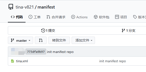

if not dry_run:
os.chdir('manifest')
tree.write('tina.xml')
run_command("git init", f"Failed to git init manifest", dry_run)
run_command("git checkout -b master", f"Failed to git checkout -b main manifest", dry_run)
run_command("git add .", f"Failed to git add manifest", dry_run)
run_command("git commit -m \"init manifest repo\"", f"Failed to git commit manifest", dry_run)
run_command(f"git remote add origin {gitea_repo_url}", f"Failed to remote add origin manifest", dry_run)
run_command(f"git push -u origin master", f"Failed to push origin manifest", dry_run)
if not dry_run:
os.chdir(os.path.dirname(os.path.abspath(__file__)))
run_command(f"rm -rf manifest", f"Failed to rm manifest", dry_run)

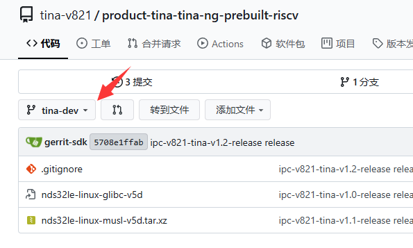

然后进入 Gitea 查看托管的仓库的分支名,随意选择一个仓库,可以看到分支名是 tina-dev

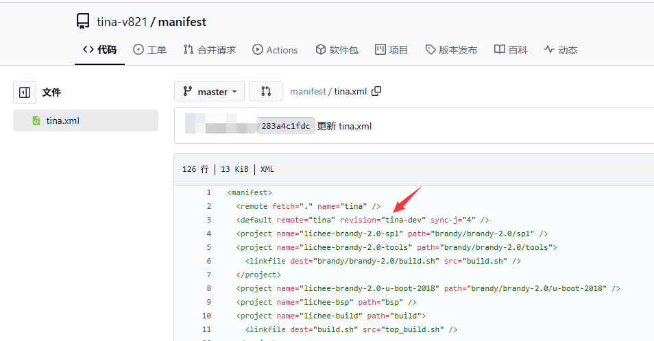

找到 manifest 仓库,编辑 tina.xml
image-20250706123156715
revision="" 中写上分支名
image-20250706123246896
至此 SDK 就已经被托管到 Gitea 中了,可以很方便的进行本地化开发工作
