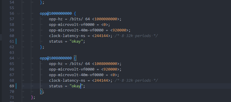

  5. 修改文件 bsp/configs/linux-5.4-ansc/sun300iw1p1-vf.dtsi 取消频点 disable
opp@960000000 {
opp-hz = /bits/ 64 <960000000>;
opp-microvolt-vf0000 = <920000>;
opp-microvolt-40m-vf0000 = <920000>;
clock-latency-ns = <244144>; /* 8 32k periods */
opp@1000000000 {
opp-hz = /bits/ 64 <1000000000>;
opp-microvolt-vf0000 = <0>;
opp@1008000000 {
opp-hz = /bits/ 64 <1008000000>;
opp-microvolt-40m-vf0000 = <0>;
image-20250613153321902

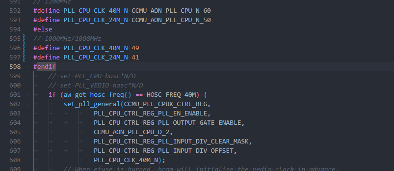

  1. 修改 brandy/brandy-2.0/spl/board/sun300iw1p1/clock.c 配置启动频率 1000MHz
void sunxi_board_pll_init(void)
#ifndef CFG_SUNXI_SIMPLEBOOT
#ifndef CFG_SUNXI_PMBOOT
printf("set pll start\n");
#ifdef CFG_SUNXI_VF_2_1
// 1200MHz
#define PLL_CPU_CLK_40M_N CCMU_AON_PLL_CPU_N_60
#define PLL_CPU_CLK_24M_N CCMU_AON_PLL_CPU_N_50
#else
// 1000MHz/1008MHz
#define PLL_CPU_CLK_40M_N 49
#define PLL_CPU_CLK_24M_N 41
// set PLL_CPU=hosc*N/D
// set PLL_VEDIO hosc*N/D
if (aw_get_hosc_freq() == HOSC_FREQ_40M) {
set_pll_general(CCMU_PLL_CPUX_CTRL_REG,
PLL_CPU_CTRL_REG_PLL_EN_ENABLE,
PLL_CPU_CTRL_REG_PLL_OUTPUT_GATE_ENABLE,
CCMU_AON_PLL_CPU_D_2,
PLL_CPU_CTRL_REG_PLL_INPUT_DIV_CLEAR_MASK,
PLL_CPU_CTRL_REG_PLL_INPUT_DIV_OFFSET,
PLL_CPU_CLK_40M_N);
// When efuse is burned, brom will initialize the vedio clock in advance.
image-20250613153750849

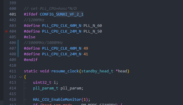

  1. 修改 rtos/lichee/rtos-components/aw/pm/plat_sun300iw1p1/firmware/standby_main.c
//1000MHz/1008MHz
image-20250613153939625
