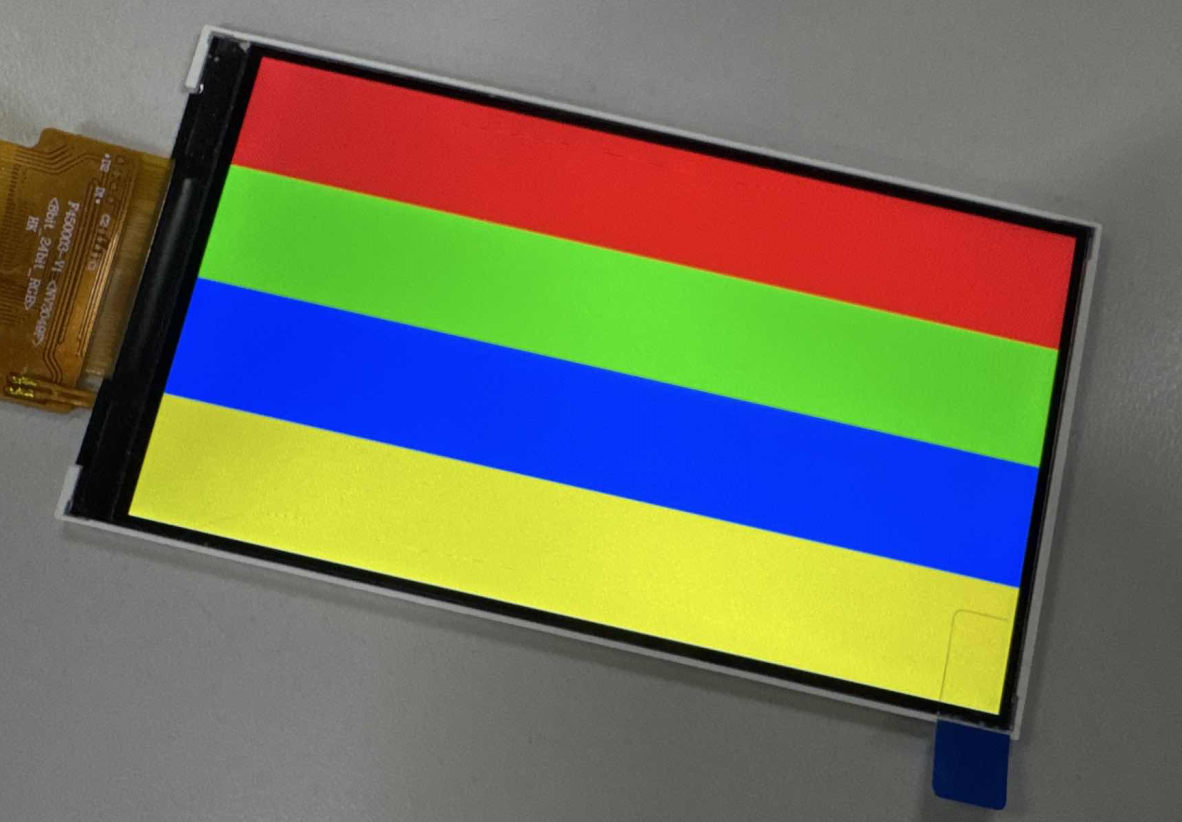

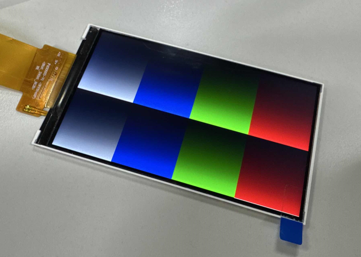

这次点的屏幕是基于 NV3049F 驱动 IC 的 854x480 Serial RGB 屏。屏幕型号为 F450003,该屏为定制屏,暂无公开型号或购买渠道。

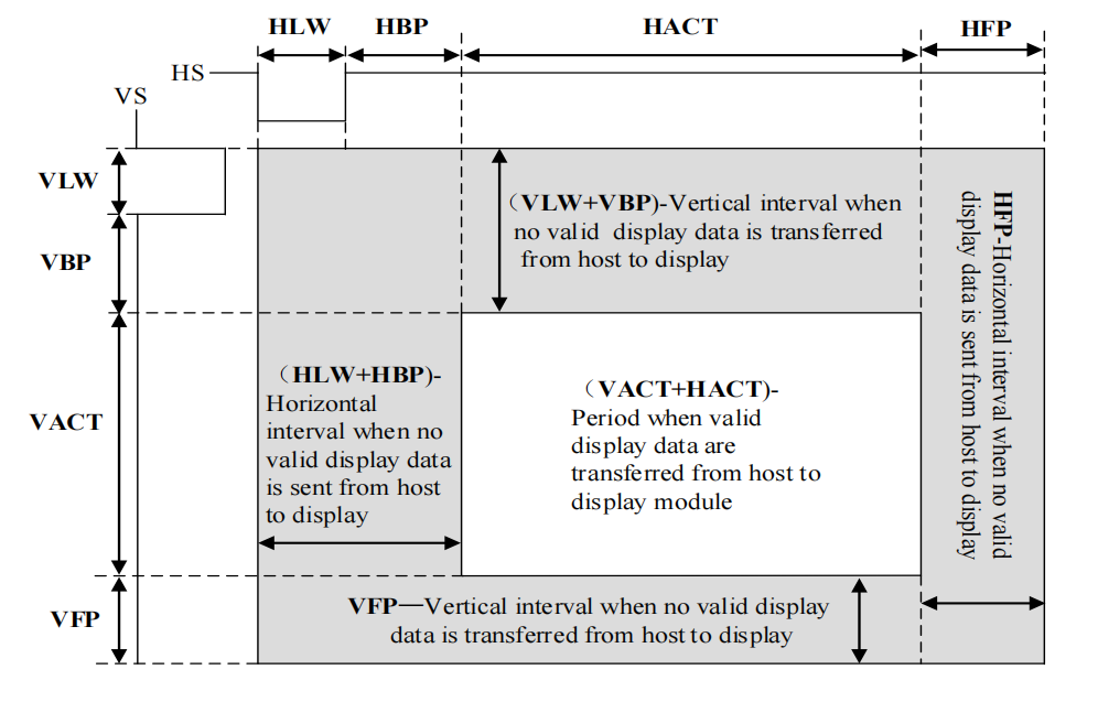

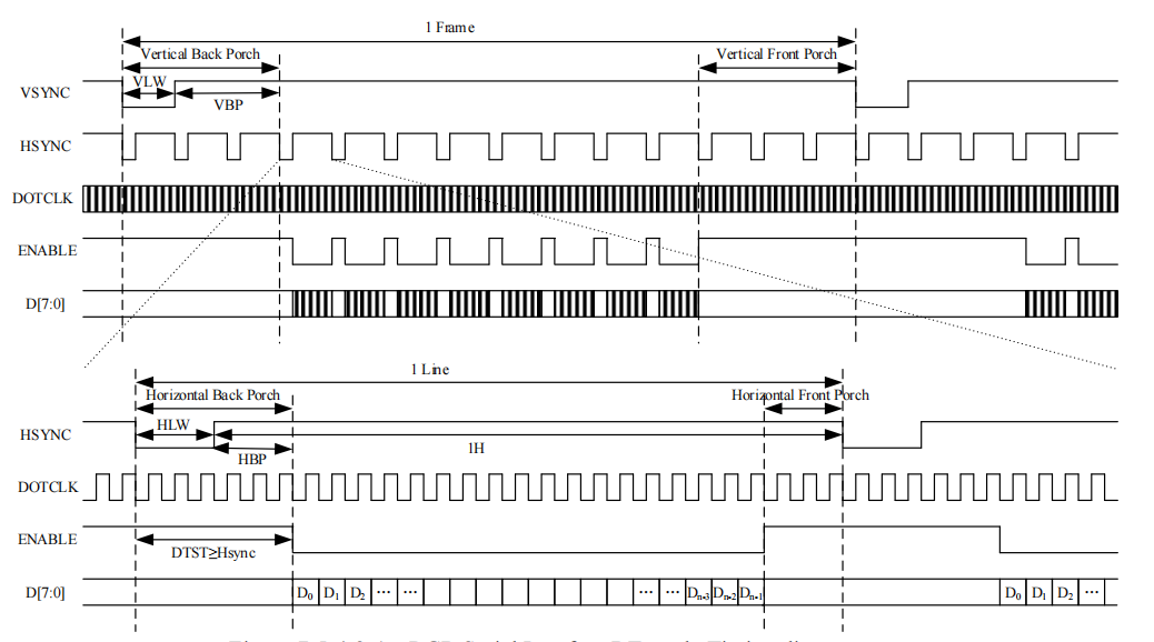

串行RGB是相对于并行RGB来说,而并不是说它只用一根线来发数据,只要通过多个时钟周期才能把一个像素的数据发完,那么这样的RGB接口就是串行RGB。也叫做 8 位 RGB 屏。
Serial RGB 时序如下:

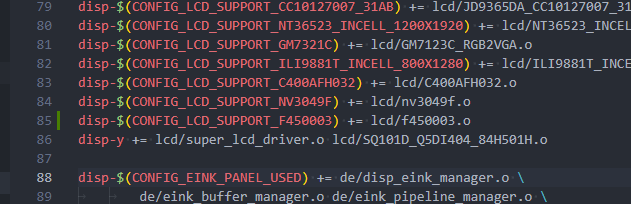

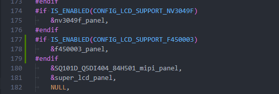

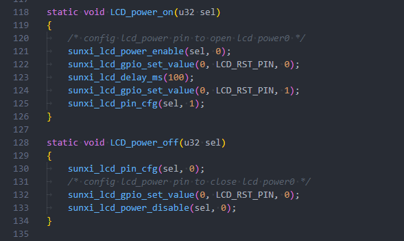

编写 LCD 显示屏驱动​
准备驱动框架​
前往屏幕驱动路径:bsp/drivers/video/sunxi/disp2/disp/lcd/ 下,将
  • bsp/drivers/video/sunxi/disp2/disp/lcd/default_panel.c
  • bsp/drivers/video/sunxi/disp2/disp/lcd/default_panel.h
复制一份作为模板
image-20250325115847538
然后改名为此款屏幕的驱动:
image-20250325120029397

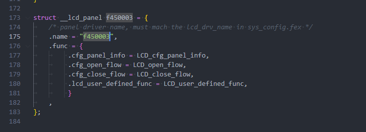

打开 bsp/drivers/video/sunxi/disp2/disp/lcd/f450003.c 文件,将 default_panel 改为 f450003
image-20250325120101625
同时修改 name,为屏幕实际名称
image-20250325120201286
头文件也一并修改
image-20250325120222052

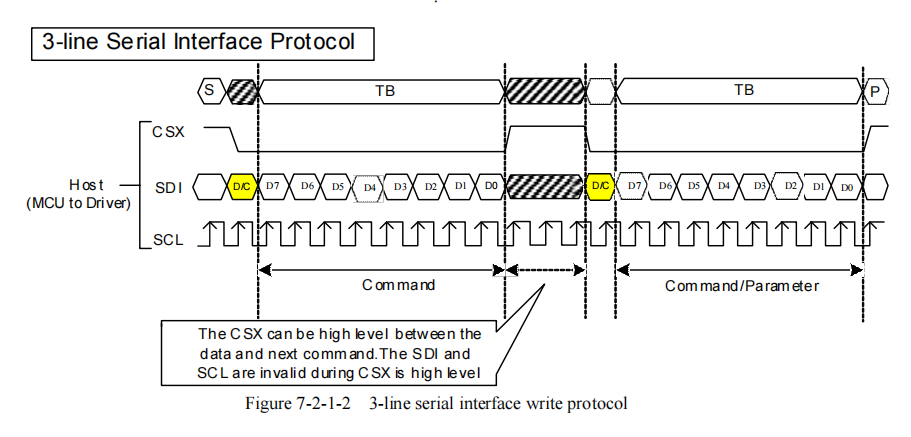

获取屏幕初始化序列​
首先询问屏厂提供初始化序列,和屏幕手册。
image-20250325113536368

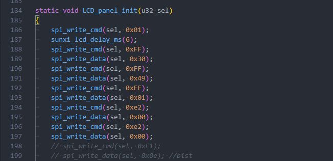

屏厂会提供一个初始化代码:
////////////////NV3049F+BOE4.5////////////////////
Write_LCD_REG_CMD(0xFF);
Write_LCD_REG_DATA(0x30);
Write_LCD_REG_DATA(0x49);
Write_LCD_REG_DATA(0x01);
Write_LCD_REG_CMD(0xe2);
Write_LCD_REG_DATA(0x00);
//Write_LCD_REG_CMD(0xF1);
//Write_LCD_REG_DATA(0x0e);//bist
Write_LCD_REG_CMD(0x14);
Write_LCD_REG_DATA(0x08);//vbp_para[7:0]
Write_LCD_REG_CMD(0x11);
Write_LCD_REG_DATA(0x08);//vfp_para[7:0]
Write_LCD_REG_CMD(0x16);
Write_LCD_REG_DATA(0x14);//hfp
Write_LCD_REG_CMD(0x19);
Write_LCD_REG_DATA(0x19);//hbp
Write_LCD_REG_CMD(0x15);//vbp_seri[7:0]
Write_LCD_REG_CMD(0x12);//vfp_seri[7:0]
Write_LCD_REG_CMD(0x17);//hfp_seri
Write_LCD_REG_CMD(0x1A);//hbp_seri
Write_LCD_REG_CMD(0x20);
Write_LCD_REG_DATA(0x5c);
Write_LCD_REG_CMD(0x21);
Write_LCD_REG_DATA(0x02);//20241227
Write_LCD_REG_CMD(0x3b);
Write_LCD_REG_DATA(0x04);//LVD
Write_LCD_REG_CMD(0x41);
Write_LCD_REG_DATA(0x32);
Write_LCD_REG_CMD(0x45);
Write_LCD_REG_DATA(0x03);
Write_LCD_REG_CMD(0x46);
Write_LCD_REG_DATA(0x55);

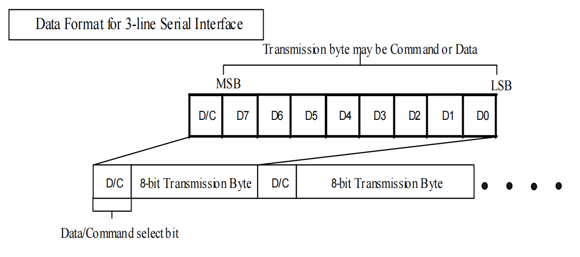

由于是 RGB 屏幕,RGB 屏幕需要使用独立的接口去写初始化代码,查询屏幕驱动 IC 手册可知是使用的是 3 线 9 BIT SPI 协议:
image-20250325113909213
其通过第一个 BIT 高低区分是 Command 还是 Data。
image-20250325113951934
正常情况下 SPI 发送为 8 Bit 模式,不支持 9 Bit 发送。这里一般采用 GPIO 模拟生成 SPI 时序方式。

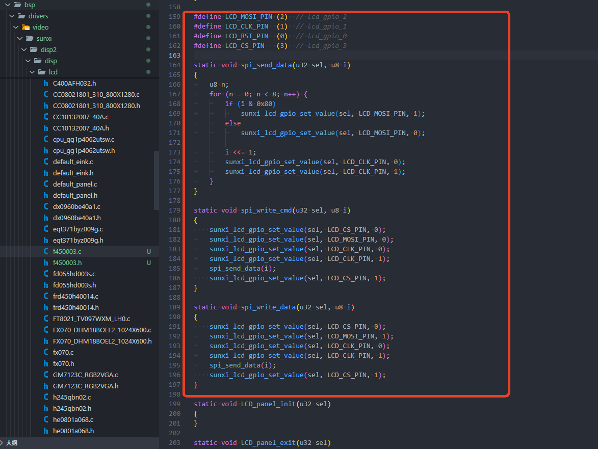

先配置设备树,设置对应的引脚
lcd_gpio_0 = <&pio PD 17 GPIO_ACTIVE_LOW>; // RESET
lcd_gpio_1 = <&pio PD 15 GPIO_ACTIVE_LOW>; // SCK
lcd_gpio_2 = <&pio PD 16 GPIO_ACTIVE_LOW>; // SDA
lcd_gpio_3 = <&pio PD 14 GPIO_ACTIVE_LOW>; // CS
然后编写驱动代码,模拟该时序
#define LCD_MOSI_PIN (2)  // lcd_gpio_2
#define LCD_CLK_PIN (1) // lcd_gpio_1
#define LCD_RST_PIN (0) // lcd_gpio_0
#define LCD_CS_PIN (3) // lcd_gpio_3
static void spi_send_data(u32 sel, u8 i)
u8 n;
for (n = 0; n < 8; n++) {
if (i & 0x80)
sunxi_lcd_gpio_set_value(sel, LCD_MOSI_PIN, 1);
sunxi_lcd_gpio_set_value(sel, LCD_MOSI_PIN, 0);
i <<= 1;
sunxi_lcd_gpio_set_value(sel, LCD_CLK_PIN, 0);
sunxi_lcd_gpio_set_value(sel, LCD_CLK_PIN, 1);
static void spi_write_cmd(u32 sel, u8 i)
sunxi_lcd_gpio_set_value(sel, LCD_CS_PIN, 0);
spi_send_data(sel, i);
sunxi_lcd_gpio_set_value(sel, LCD_CS_PIN, 1);
static void spi_write_data(u32 sel, u8 i)
实现屏幕初始化​
把上面实现的 GPIO 模拟 3SPI 函数写入驱动程序。
image-20250325125518996

实现开关屏函数,主要是操作 RST 引脚
image-20250325125920977

static void LCD_panel_init(u32 sel)
spi_write_cmd(sel, 0x01);
sunxi_lcd_delay_ms(6);
spi_write_cmd(sel, 0xFF);
spi_write_data(sel, 0x30);
spi_write_data(sel, 0x49);
spi_write_data(sel, 0x01);
spi_write_cmd(sel, 0xe2);
spi_write_data(sel, 0x00);
// spi_write_cmd(sel, 0xF1);
// spi_write_data(sel, 0x0e); //bist
spi_write_cmd(sel, 0x14);

spi_write_cmd(sel, 0xf7);
spi_write_data(sel, 0x50);
spi_write_cmd(sel, 0xf8);
spi_write_data(sel, 0xC4); //
//Write_LCD_REG(0x0000,0x0035);
//Write_LCD_REG(0x0000,0x0100);
//Write_LCD_REG(0x0000,0x003A);
//Write_LCD_REG(0x0000,0x0150);
//spi_write_cmd(sel, 0x21);
//spi_write_data(sel, 0x00);
spi_write_cmd(sel, 0x11);
sunxi_lcd_delay_ms(200);
spi_write_cmd(sel, 0x29);

/* sel: 0:lcd0; 1:lcd1 */
static s32 LCD_user_defined_func(u32 sel, u32 para1, u32 para2, u32 para3)
struct __lcd_panel f450003 = {
/* panel driver name, must mach the lcd_drv_name in sys_config.fex */
.name = "f450003",
.func = {
.cfg_panel_info = LCD_cfg_panel_info,
.lcd_user_defined_func = LCD_user_defined_func,
配置编译驱动​

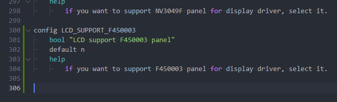

编辑 bsp/drivers/video/sunxi/disp2/disp/lcd/Kconfig 文件,增加新驱动配置
config LCD_SUPPORT_F450003
bool "LCD support F450003 panel"
default n
help
if you want to support F450003 panel for display driver, select it.
image-20250325130631665
编辑 bsp/drivers/video/sunxi/disp2/disp/Makefile 增加配置
disp-$(CONFIG_LCD_SUPPORT_F450003) += lcd/f450003.o
image-20250325130723864
编辑 bsp/drivers/video/sunxi/disp2/disp/lcd/panels.c 新增屏幕引用
#if IS_ENABLED(CONFIG_LCD_SUPPORT_F450003)
&f450003_panel,
image-20250325130825431

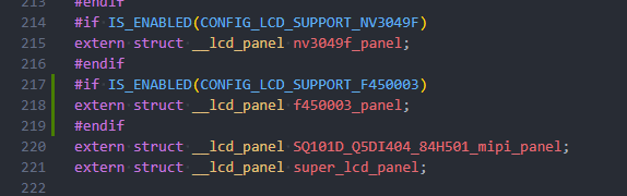

编辑 bsp/drivers/video/sunxi/disp2/disp/lcd/panels.h 新增屏幕引用
extern struct __lcd_panel f450003_panel;
image-20250325130858372
获取屏幕时序​
由于使用的是 Serial RGB,其 RGB 时序参考入下图所示。
image-20250325114233418
屏幕时序参数与屏幕时间显示数据如下图所示:
image-20250325114034805
这里需要注意的是,对于该接口,SoC总共需要三个周期才能发完一个pixel,所以我们配置时序的时候,需要满足
lcd_dclk_freq×3=lcd_ht×lcd_vt×60\text{lcd\_dclk\_freq} \times 3 = \text{lcd\_ht} \times \text{lcd\_vt} \times 60
或者
lcd_dclk_freq=lcd_ht×3×lcd_vt×60\text{lcd\_dclk\_freq} = \text{lcd\_ht} \times 3 \times \text{lcd\_vt} \times 60
要么配置 3 倍 lcd_ht 要么 3 倍 lcd_dclk_freq。
此时一般询问屏厂,让其提供 RGB 时序配置,将时序参数配置为:
lcd_dclk_freq       = <77>;
lcd_hbp = <23>;
lcd_ht = <1479>;
lcd_hspw = <2>;
lcd_vbp = <8>;
lcd_vt = <870>;
lcd_vspw = <2>;

使用命令查看 TCON 彩条,这个彩条是由 TCON 发出的,操作更加底层。
image-20250325132030601
使用命令查看 DE 彩条,这个彩条是由 DE 合成发出的,如果 DE 出问题则可以看到 TCON 彩条看不到 DE 彩条。
tip
note
note
如果刚才开了 TCON 彩条,记得先关一下,TCON 彩条优先级更高
echo 0 > /sys/class/disp/disp/attr/colorbar
echo 8 > /sys/class/disp/disp/attr/colorbar
image-20250325132046383
