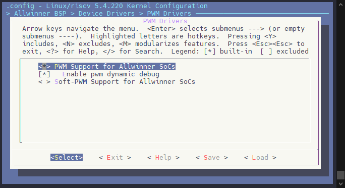

模块配置​
驱动配置​
驱动位于
Allwinner BSP  --->
Device Drivers --->
PWM Drivers ->
<*> PWM Support for Allwinner SoCs
< > Soft-PWM Support for Allwinner SoCs
image-20250701101503807
