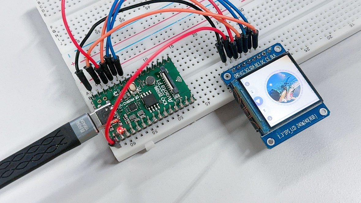

此次适配的SPI屏为 ZJY130S0800TG01,使用的是 SPI 进行驱动。
image-20250322173114246
引脚配置如下:
V861TFT 模块
PD1CS
PD2SCL
PD3SDA
3V3BLK
PD4RES
PD5DC
3V3VCC
GNDGND

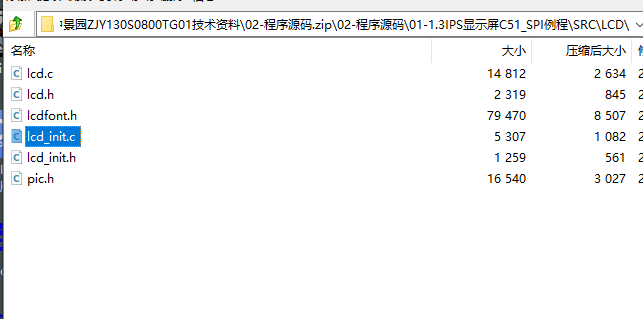

获取屏幕初始化序列

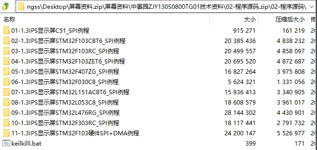

首先询问屏厂提供驱动源码
image-20231023102239928
找到 LCD 的初始化序列代码
image-20231023102252129

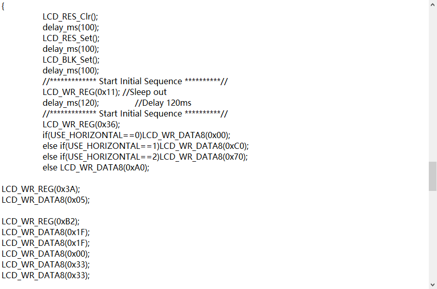

找到屏幕初始化的源码
image-20231023102333476
整理后的初始化代码如下:

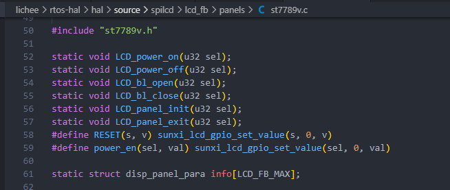

编辑 st7789v.cnv3029s 改成 st7789v
image-20231017104942286

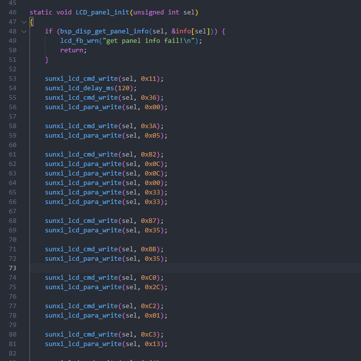

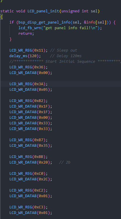

编写初始化序列
先删除 static void LCD_panel_init(unsigned int sel) 中的初始化函数。
image-20231017105101421
然后将屏厂提供的初始化序列复制进来
image-20231023102641761
然后按照 spi_lcd 框架的接口改写驱动接口,具体接口如下
屏厂函数SPILCD框架接口
LCD_WR_REGsunxi_lcd_cmd_write
LCD_WR_DATA8sunxi_lcd_para_write
delay_mssunxi_lcd_delay_ms
可以直接进行替换
image-20231023095114146
完成后如下
image-20231023095158411

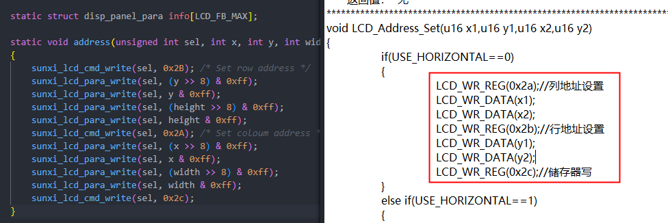

然后对照屏厂提供的驱动修改 address 函数
image-20231023102549896
做如下修改
static void address(unsigned int sel, int x, int y, int width, int height)
sunxi_lcd_cmd_write(sel, 0x2B); /* Set row address */
sunxi_lcd_para_write(sel, (y >> 8) & 0xff);
sunxi_lcd_para_write(sel, y & 0xff);
sunxi_lcd_para_write(sel, (height >> 8) & 0xff);
sunxi_lcd_para_write(sel, height & 0xff);
sunxi_lcd_cmd_write(sel, 0x2A); /* Set coloum address */
sunxi_lcd_para_write(sel, (x >> 8) & 0xff);
sunxi_lcd_para_write(sel, x & 0xff);
sunxi_lcd_para_write(sel, (width >> 8) & 0xff);
sunxi_lcd_para_write(sel, width & 0xff);
sunxi_lcd_cmd_write(sel, 0x2c);

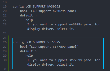

完成了屏幕驱动的编写,接下来需要对接到 SPILCD 驱动框架。首先编辑 Kconfig,增加 st7789v 的配置
image-20231017105814814
config LCD_SUPPORT_ST7789V
bool "LCD support st7789v panel"
default n
---help---
If you want to support st7789v panel for display driver, select it.

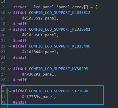

然后编辑 panels.cpanel_array 里增加 st7789 驱动的引用
image-20231017105948156
如下图
image-20231017105919628

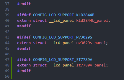

#ifdef CONFIG_LCD_SUPPORT_ST7789V
&st7789v_panel,
之后编辑 panels.h 同样增加引用
image-20231017110043805
如下图
image-20231017110122397
extern struct __lcd_panel st7789v_panel;

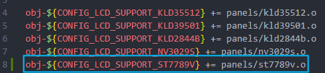

最后编辑外层的 Makefile 增加编译选项,如下所示
image-20231017110242997
obj-${CONFIG_LCD_SUPPORT_ST7789V} += panels/st7789v.o

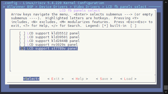

选择驱动
进入内核驱动配置界面,勾选新增的驱动
Allwinner BSP  --->
Device Drivers --->
Video Drivers --->
SPI LCD Panel Drivers --->
LCD FB Panels select --->
[*] LCD support st7789v panel

lcd_spi_dc_pin = <&pio PD 5 GPIO_ACTIVE_LOW>;
功能测试
勾选 LVGL,运行测试
lv_examples 1
屏幕可以正常显示,帧率正确即可。
tip
note
note
LVGL 颜色不对的时候记得配置
/*Color depth: 1 (1 byte per pixel), 8 (RGB332), 16 (RGB565), 32 (ARGB8888)*/
#define LV_COLOR_DEPTH 16
/*Swap the 2 bytes of RGB565 color. Useful if the display has an 8-bit interface (e.g. SPI)*/
#define LV_COLOR_16_SWAP 1
