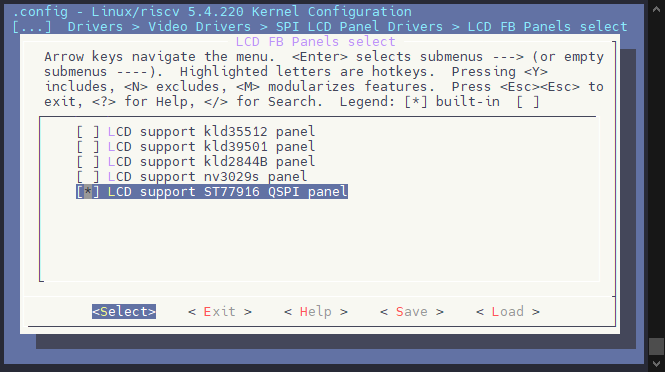

勾选驱动​
Allwinner BSP  --->
Device Drivers --->
Video Drivers --->
SPI LCD Panel Drivers --->
<*> LCD FB Driver Support (SPI LCD)
LCD FB Panels select --->
[*] LCD support ST77916 QSPI panel
image-20250417103054875

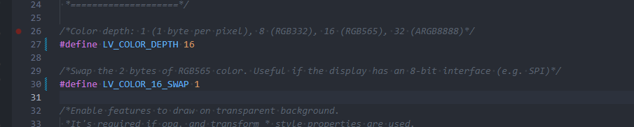

修改 LVGL​
配置 LVGL 色深 RGB565,反转 byte,修改文件 platform/thirdparty/gui/lvgl-8/lv_examples/src/lv_conf.h
/*Color depth: 1 (1 byte per pixel), 8 (RGB332), 16 (RGB565), 32 (ARGB8888)*/
#define LV_COLOR_DEPTH 16
/*Swap the 2 bytes of RGB565 color. Useful if the display has an 8-bit interface (e.g. SPI)*/
#define LV_COLOR_16_SWAP 1
image-20250417114845701

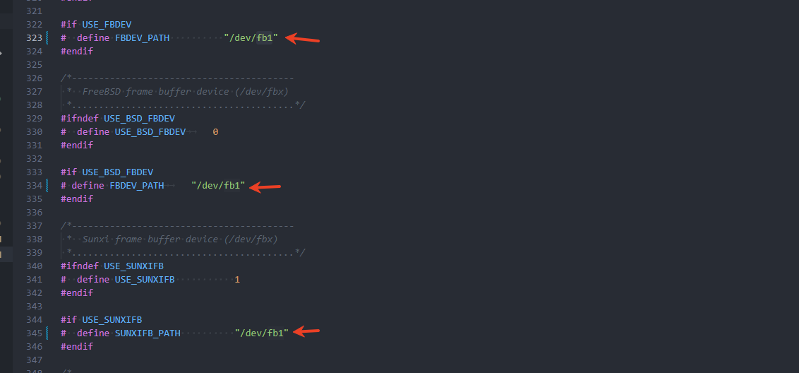

LVGL 需要编译两个版本,一个在 fb0 显示,一个在 fb1 显示。
编辑 platform/thirdparty/gui/lvgl-8/lv_examples/src/lv_drv_conf.h,将 fb0 修改为 fb1
image-20250417114741300

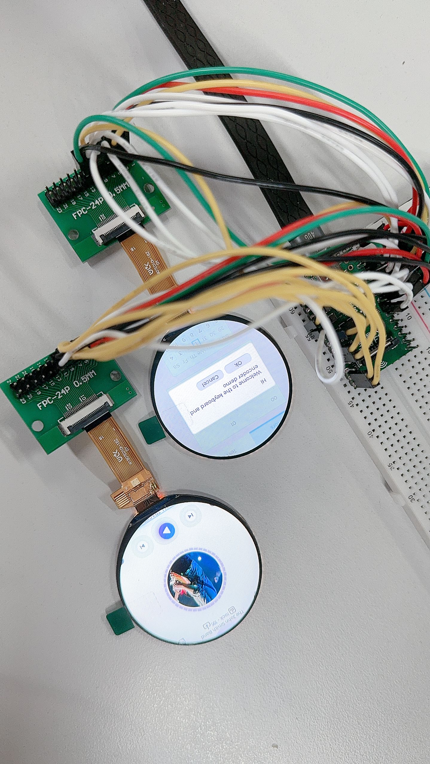

勾选 LVGL,运行测试
lv_examples 1
lv_examples_fb1 1
屏幕可以正常显示,帧率正确即可。
