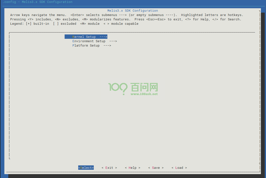

1.2 E907配置项​
​ E907开发包的配置与Tina SDK的配置类似,在e907_rtos/rtos/source目录下,执行make menuconfig
例如:
book@100ask:~/workspaces/e907_rtos/rtos/source$ make menuconfig
执行完成后会进入如下界面:
image-20230504112330976

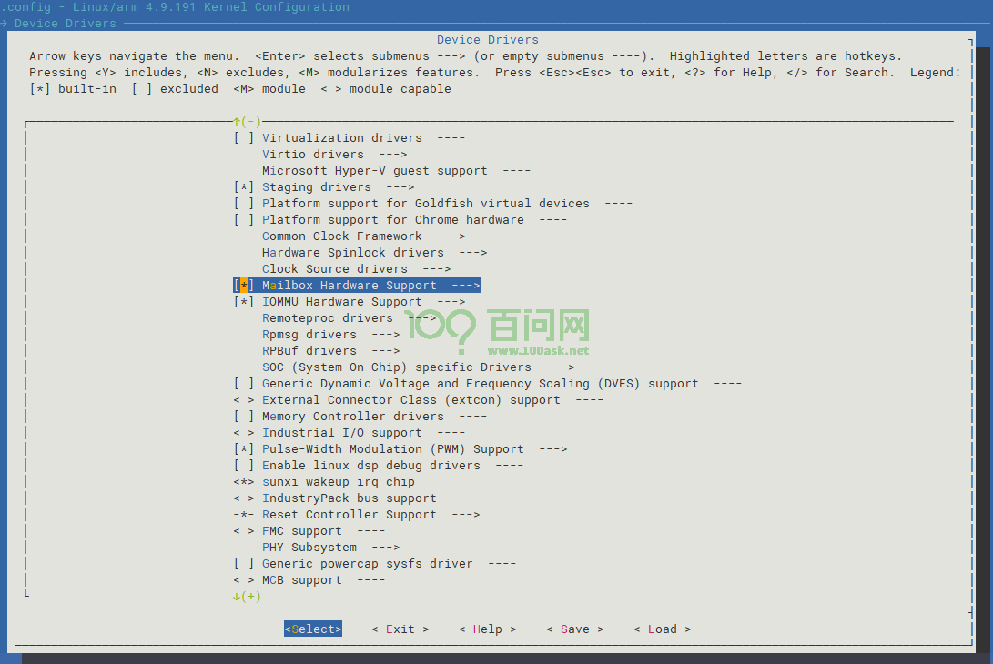

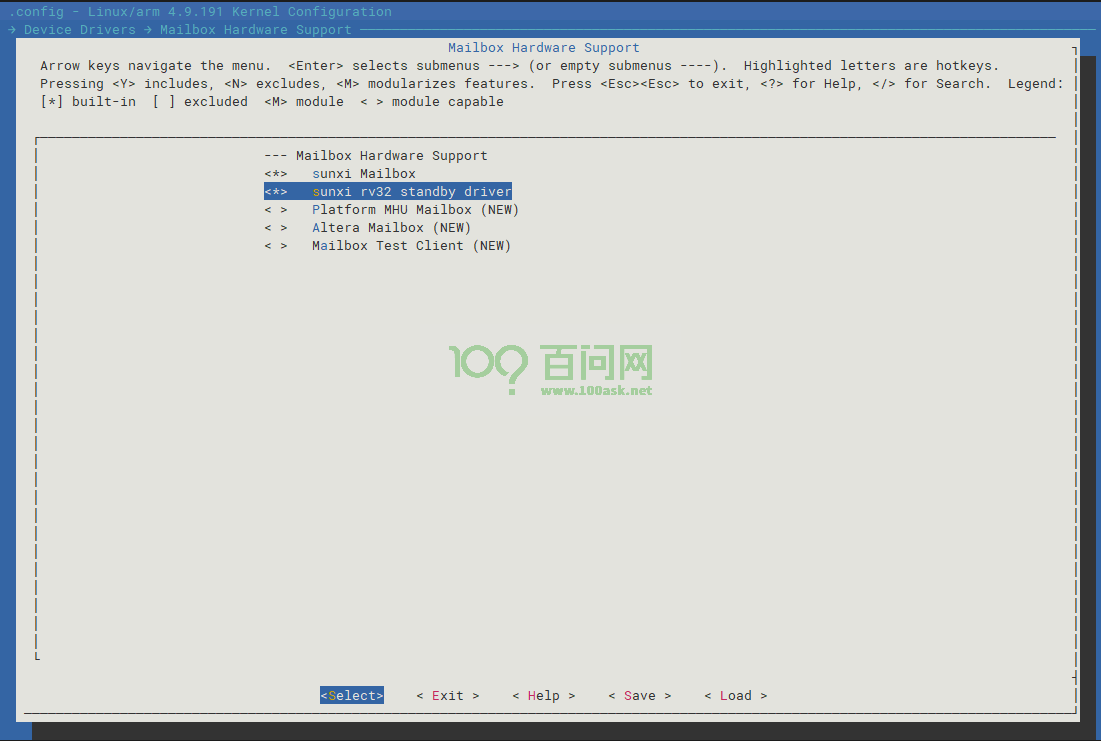

1.使能硬件支持
进入内核配置界面后,进入Device Drivers 目录,选中Mailbox Hardware Support,如下图所示
image-20230504145616213
选中后进入Mailbox Hardware Support目录中,选中sunxi Mailbox和sunxi rv32 standby driver,选中完成后如下图所示:
image-20230504145817407

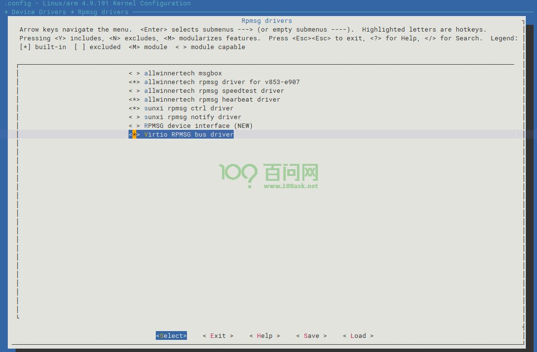

2.使能RPMsg驱动
进入如下目录中
→ Device Drivers
→ Rpmsg drivers
选中如下配置
<*> allwinnertech rpmsg driver for v853-e907
<*> allwinnertech rpmsg hearbeat driver
<*> sunxi rpmsg ctrl driver
<*> Virtio RPMSG bus driver
选中完成后如下图所示:
image-20230504145408205

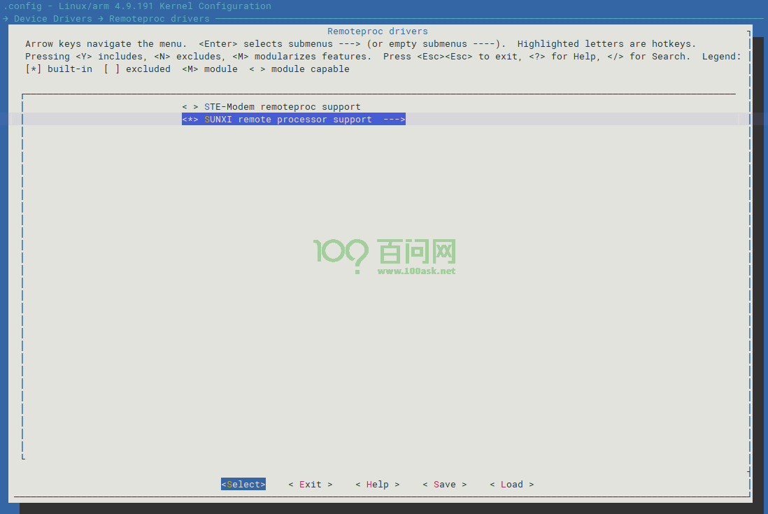

3.使能共享内存驱动
​ 进入如下目录中
→ Device Drivers
→ Remoteproc drivers
选中如下配置
<*> SUNXI remote processor support  --->
如下图所示:
image-20230504150510997
修改完成后,保存内核配置并退出。

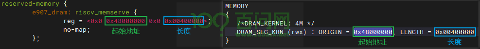

修改kernel.lds,找到MEMORY节点,修改起始地址为0x48000000,长度为0x00400000。此参数需要和Tina设备树中的E907内存参数一致,所以可修改MEMORY节点参数为:
MEMORY
/*DRAM_KERNEL: 4M */
DRAM_SEG_KRN (rwx) : ORIGIN = 0x48000000, LENGTH = 0x00400000
两者对比图如下:
image-20230504152546509

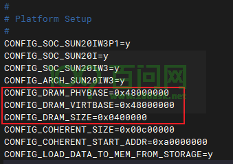

2.2.2 修改E907配置​
进入e907_rtos/rtos/source/projects/v853-e907-100ask/configs目录下,修改defconfig文件,例如:
book@100ask:~/workspaces/e907_rtos/rtos/source/projects/v853-e907-100ask$ cd configs/
book@100ask:~/workspaces/e907_rtos/rtos/source/projects/v853-e907-100ask/configs$ ls
defconfig sys_config.fex
修改下面三个参数为:
CONFIG_DRAM_PHYBASE=0x48000000
CONFIG_DRAM_VIRTBASE=0x48000000
CONFIG_DRAM_SIZE=0x0400000
如下图所示:
image-20230504153420513

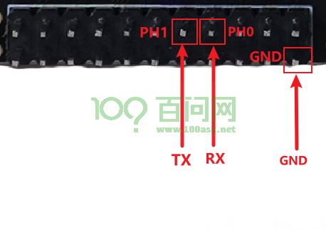

2.2.3 使用uart3输出信息​
1.修改引脚复用
配置引脚复用文件,进入e907_rtos/rtos/source/projects/v853-e907-100ask/configs目录下

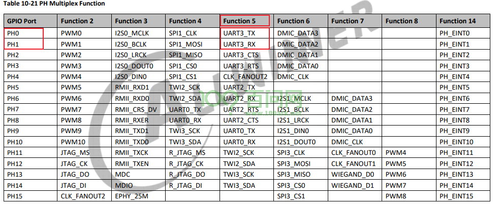

修改sys_config.fex文件,通过查询数据手册,查看引脚复用功能,我们使用PH0和PH1作为uart3功能
image-20230504161901226
修改uart3节点为:
[uart3]
uart_tx = port:PH00<5><1><default><default>
uart_rx = port:PH01<5><1><default><default>

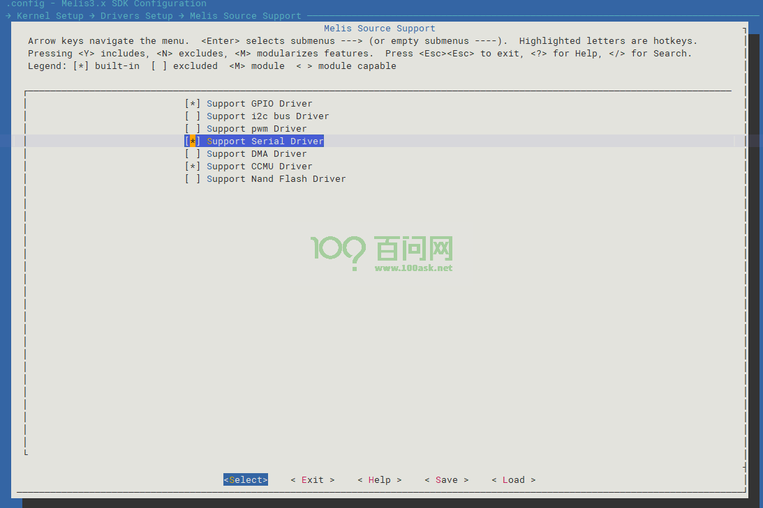

2.修改配置
在e907_rtos/rtos/source目录下输入make menuconfig,进入E907配置界面
进入如下目录,选中[*] Support Serial Driver
 → Kernel Setup
→ Drivers Setup
→ Melis Source Support
image-20230504155321387

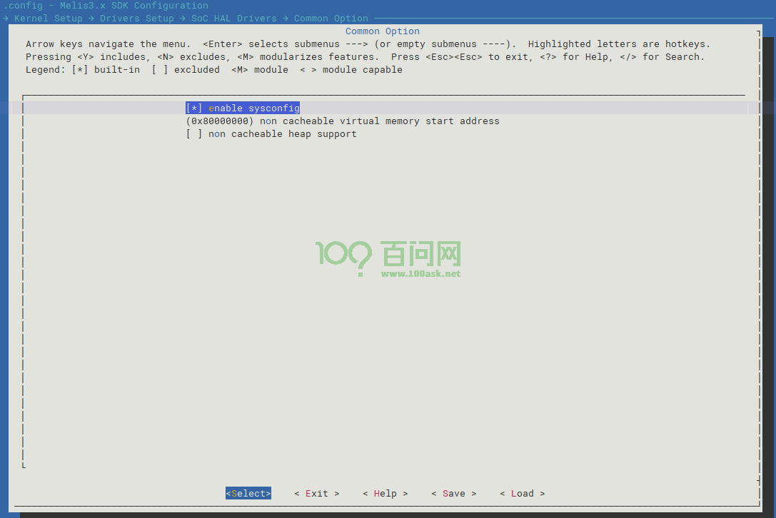

进入如下目录,选中[*] enable sysconfig,启用读取解析 sys_config.fex 功能
 → Kernel Setup
→ Drivers Setup
→ SoC HAL Drivers
→ Common Option
image-20230504155644570

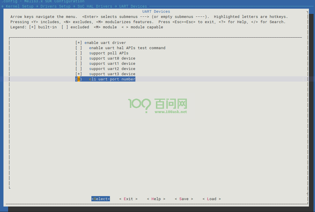

进入如下目录中,启用uart驱动,并使用uart3。
 → Kernel Setup
→ Drivers Setup
→ SoC HAL Drivers
→ UART Devices
[*] enable uart driver
[*] support uart3 device
(3) cli uart port number
image-20230504155927822

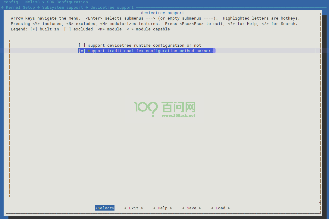

进入如下目录,启用sys_config.fex 解析器
 → Kernel Setup
→ Subsystem support
→ devicetree support
[*] support traditional fex configuration method parser.
image-20230504160213237
保存并退出E907配置。

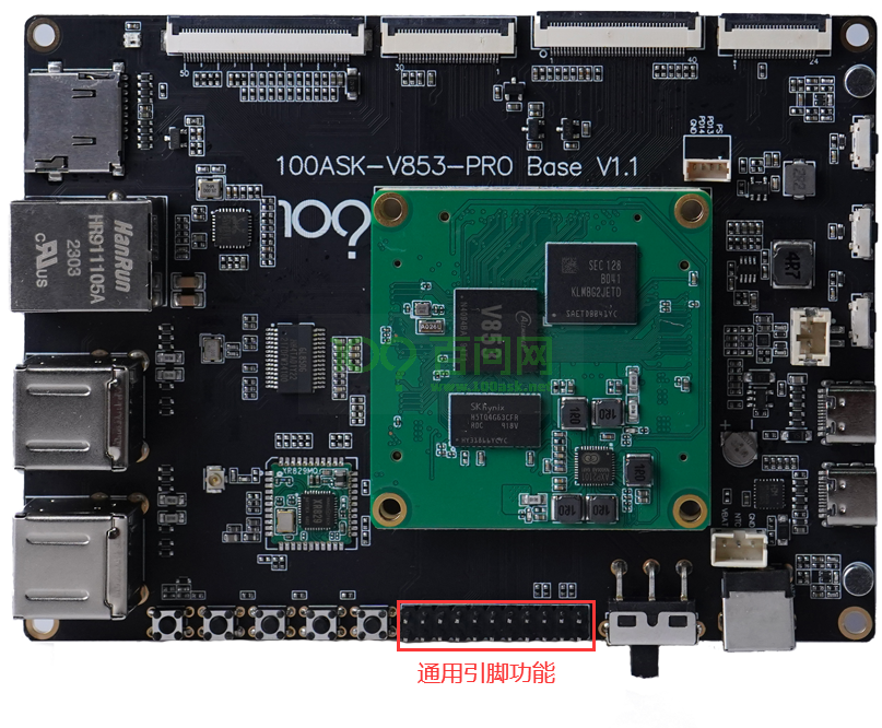

2.4.1 连接开发板的uart3​
​ 此时需要使用USB转串口模块,连接我们上面设置的uart3。我们需要找到开发板上的PH0、PH1、GND,分别连接到USB转串口模块的RXD、TXD、GND。DongshanPI-AICT开发板已经将PH0、PH1、GND引出来,位置图图下所示
image-20230504175344715

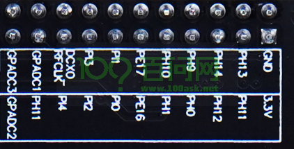

具体的引脚可查看开发板背面的丝印,确认引脚位置。
image-20230504175534607
通过背面的丝印可以知道PH0、PH1、GND的位置,如下图所示,PH0、PH1、GND,分别连接到USB转串口模块的RX、TX、GND。
image-20230504180138631
连接完成后将USB转串口模块插入windows主机端后,使用串口软件打开uart3串口界面,波特率为115200。
